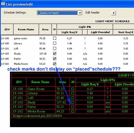

The check mark displays in the interactive preview but not when placed. Has anyone else experienced this?

Hi Dan I dont know the answer to your problem as i cant work out how you added a custom zone parameter to your IS in the first place
Are you able to explain where you did that, it would be much appreciated.
Also did you sort out your problem?
Anyone else is welcome to chime in
cheers
cheers

Aussie wrote:John,
cheers
Its been a while since I've done this but I think I remember...so here goes:
Click the "Addtional Parameters" tab and select "All Types by Subtype"
Now under "Select Library Parts", click to: General GDL Object/Drawing Symbol/Zone Stamp/(select the stamp you desire parameters from)
HTH,
Dan K

thanks "select "All Types by Subtype"" was the bit I had missed
