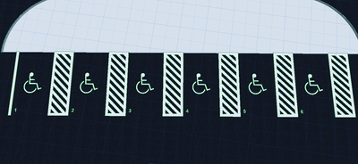

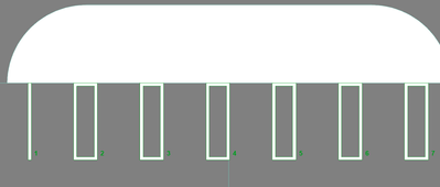

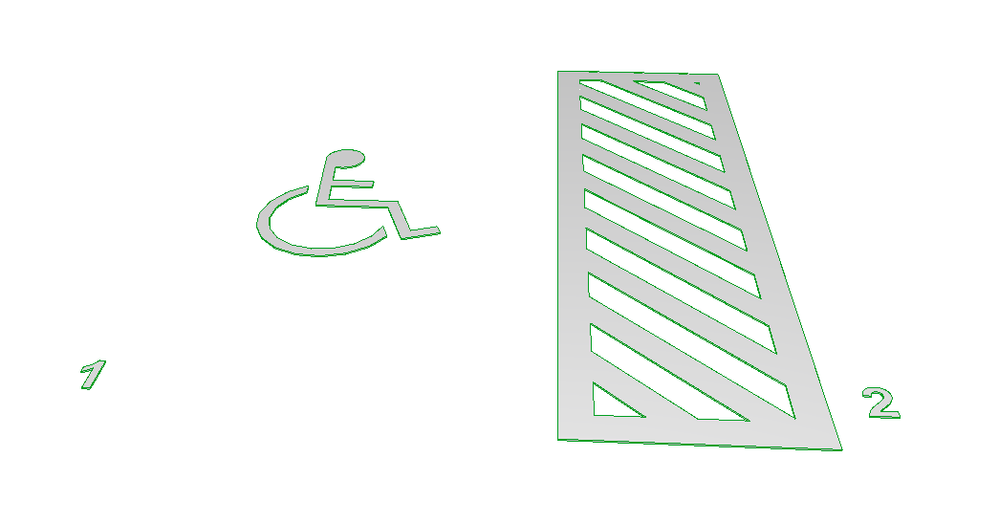

Hi @mrsneuna,
I don't know if you are using a default Archicad library object called (Parking Place) or not.
But if you use it here're the adjustments in 2D & 3D to get the desired result, I hope that helps.
