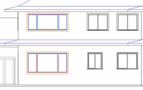

I am having some trouble getting the apron to show up on windows from the ArchiCAD 8 Library.
A typical window that I am having this problem with is the "W Gliding2 80".
If I create windows using "Door and Window Builder" the apron shows up just fine.
I do have the Options/2d and 3d set to Detailed.
I am attaching a couple of screen shots to show the window and it's settings. THe windows on the left were created using Door and Window Builder. The windows on the right are from the ArchiCAD 8 Library.
How can I get the standard ArchiCAD 8 Library windows to show up in the elevation? What setting controls the apron look in an elevation?

I swithced the windows to W Horizontal Slide from the Windows Classic 8 Library. The apron shows up just fine with these windows. If my problem is a bug I hope that it gets fixed.
