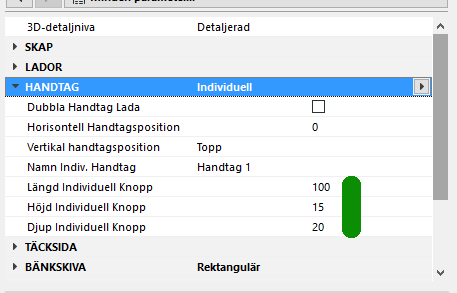

Hi All,
these parameters can specified on the "All parameters" tab, they are not out on the user interface. Please see the attached screenshot.
