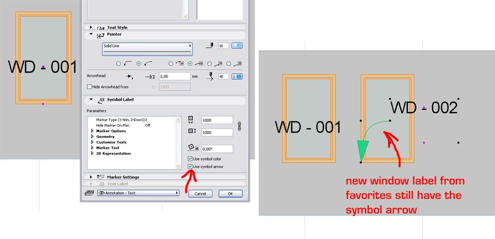

1. I set the parameters of geometry, turned off the symbol arrow of the label and saved it to Favorites to use it on other window/door, but every time I use it, the symbol arrow appears on new W/D.
2. Is it possible to make my label as a default in new project?
