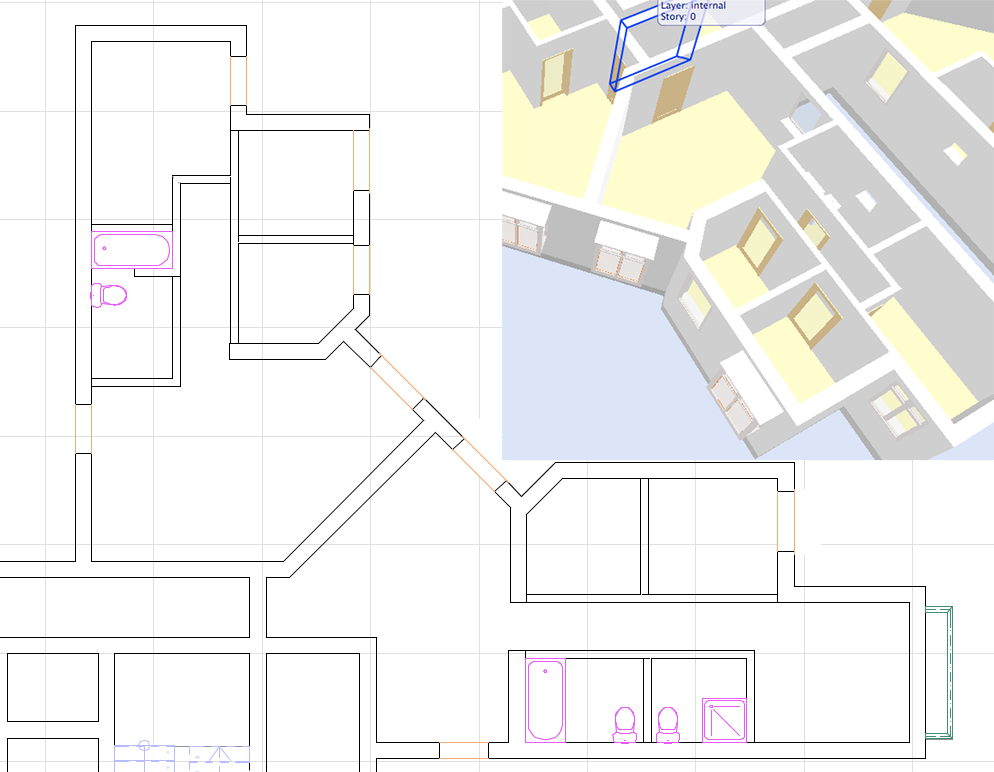

windows and door can't show in plan
i've shown all the layers but i don't know why all the windows and doors can not show properly, you can see in 3D, i have some bay windows.......
please help

Model view options may have your answer.
In MVO, look at door options, upper right hand side.
Bay window(s) may be a cut plane issue
If it is a cut plane issue, that does not effect 3D view.

thanks, everything shows well again!!!!!!!!!!!!!!!!!!!!!!!!!
oh my....... why.....the doors are missing again but i've checked the boxes in model view options............
Thomas Holm
Check your floor plan cut plane level.
thanks all!!!
appreciate so much for the guys here
learnt 2 features this time!! Model View Option and Floor Plan Cut Plane
