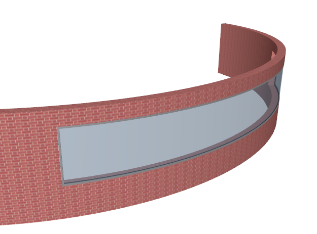

the curved window in that post just makes a hole for the window which follows the curve but the glass stays flat.

if i use that window its fine standard, but if i make it wider then it does as shown in that photo

on mine the frame follows the buildings curve but the glass stays
straght..
