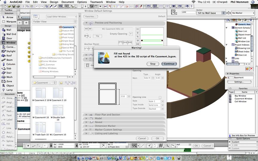

I am fairly new to working in ArchiCAD but I have gone through the video tutorials and now off and running.
I am working on an old prison building and the windows that come with ArchiCAD need a fair amount of adjusting in the dialog box before they look something like I need, however there now seems to be an error in the code when it tries to draw/render these in 3D.
Below is the error message I get.
"Fill not found at line 425 in the 3D script of file Casement_d.gsm."
Any help would be good.
PJ[/img]

Which version of AC and what platform are you on?
You should include these in your signature.
This may just be a GDL script error bug, you could open up the library part, command/control O and do a script check on the 3D window.
Or, as with other library parts, some of the windows might have minimum and/or maximum parameter sizes coded in and you are exceeding its limitation. Just a guess, but as you are working on a prison, perhaps you are trying to make your windows a narrow vertical slit and the narrowness might be the problem. Here in the states cell windows are something like 4-1/2" wide.
This said, could you elaborate?
A screen shot of your window settings would also be helpful.
Erika
Architect, Consultant
Mac OSX 10.11.1
AC5-18
Onuma System
Thanks for the tips, and have now adjusted my signature.
I have included a screen shot of the situation, the explanation of the solution is somewhat lost on me. If I press command/control and O then it simply brings up the dialog box to open a new file. I assume this works on different ver. of the software and it was my fault for not making that information known.
As for the sizes of the window, the cell windows are an old victorian design and are roughly 4' x 2' with a masonry arch above the top of them.
With this new information I hope it is more descriptive.
PJ
