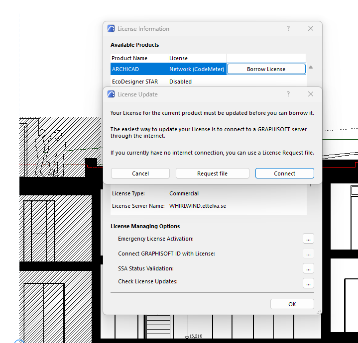

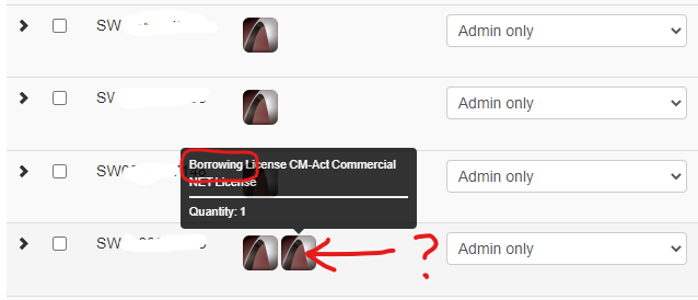

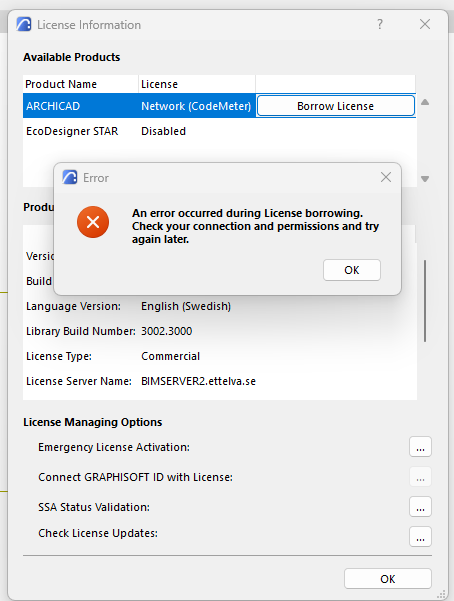

Thank you Minh
It seems we have issues with the "Borrowing" aspect of this.
We are trying to figure out what the issue may be and we get two different types of error messages (Images: Error 01, Error 02).
The question is if any number of our soft licenses can be borrowed for that 30 day period?
For example: from a key with 5 seats (Image: License 01) - can all 5 be borrowed for 30 days or does the borrowing only apply to the key with the single "Borrowing license" (Image: License 02)

MinhNguyen
From the screenshot, I could see that only License 02 has the ability to give a borrow license. It's an additional product on top of the existing license, so if you don't have it on the other key with 5 licenses, you won't be able to use borrow function here. The number of borrowable licenses equals the number of "Borrowing License" you can see in your pool, in this case only 1.
Regarding the error: the second error is not really an error. If you click Connect, the process should continue (if there is a borrowable license available).
The first error is more serious. There's not a lot of info I can get from here, usually I need a cmdust log after the error happens. Anyhow, I could see that you had 2 license servers. Maybe you haven't set up Codemeter on the server to allow the Borrowing function? Also, as we can only borrow one license here, better check if your Archicad is getting a license from the server where there is a borrowable license available
