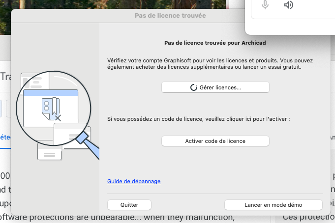

When I open archicad it says I don't have any license, even if I am logged in under a correct email. The license is showing turned on on the desktop on my profile.
I can't find technical support... and the measures taken, updating Archicad, don't work for me.
These software protections are unbearable... when they malfunction, and of course, it's at the wrong time.
I need help.

Thank you very much... I had to update the LMT as well as Archicad, what a waste of sweat and time!

I had that problem and managed to solve it by reinstalling the license management application. The latest version available.
