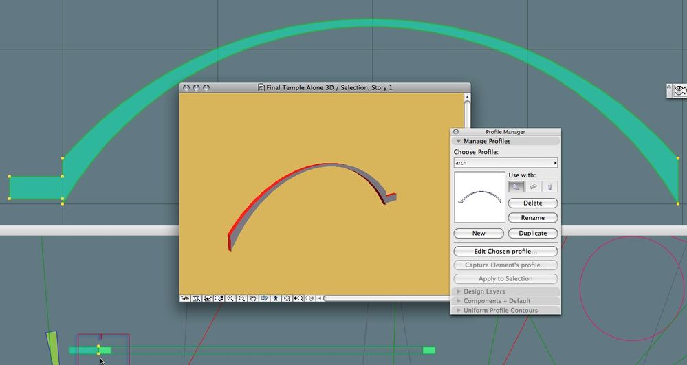

parabolic arch

The complex profile tool turns a fill into a wall.
Make the fill look like the parabola
Draw the wall perpendicular to the arch direction.

and taper the arch with a solid element operation
