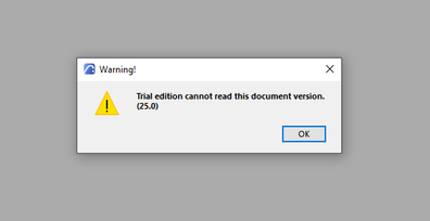

I was working in the educational version and my license has expired, then i installed the trial version to continue working, but the educational files won't open, it was both 25 Archicad version, what can i do?

Educational Files can only be opened by EDU version.
Full Commercial version can open them but it will switch to EDU version.
Trial version can only open files created with that specific Trial version.
