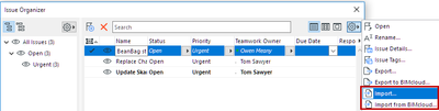

Import BCF issues
  • Go to Issue Organizer.
  • From the Additional Settings pop-up button, choose Import or Import from BIMcloud.
  • If needed, log in to BIMcloud.
  • Browse to a BCF file in version 3.0, 2.1, or 2.0.
  • Click Open.
  • In the Locate IFC Files dialog, optionally locate the IFC files referenced by the BCF entry, or click Continue to skip that step.
  • Click Continue to finish the import.
  • Review the imported issues in Issue Organizer; newly imported issues appear in bold until you open them.

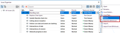

Export BCF issues
Use Issue Organizer to export the issue set in BCF format when you need to send coordination issues to project partners working in other BIM tools. Because BCF is part of the same Issue Handling workflow, you can use it to keep model-based coordination moving without rebuilding the issue list in a separate system.
