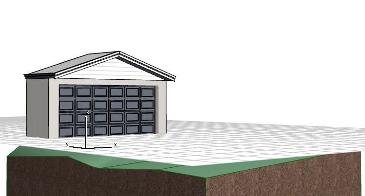

3D GRID is in the way
I would really like to be able to disable the 3D grid that appears on an OPEN GL view. It is difficult to edit otherwise.

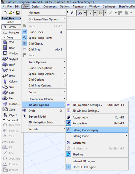

Nando Mogollon
Director @ BuilDigital
nando@buildigital.com.au
Hey Dennis,
I have added a couple of notes to Nando's image to explain a little more.
NandoMogollon
Thanks Barry
Nando Mogollon
Big cheers to you again Barry!
It appears that my view menu is missing a few of the items comparing to your attachment at the base of the View drop-down but I have just added in the "editing plane display" to it and it works fine thank you. Is there such a thing as a standard menu format like how yours is set up? I haven't gone there since I installed this V15 and have only used the default drop-down menus.
