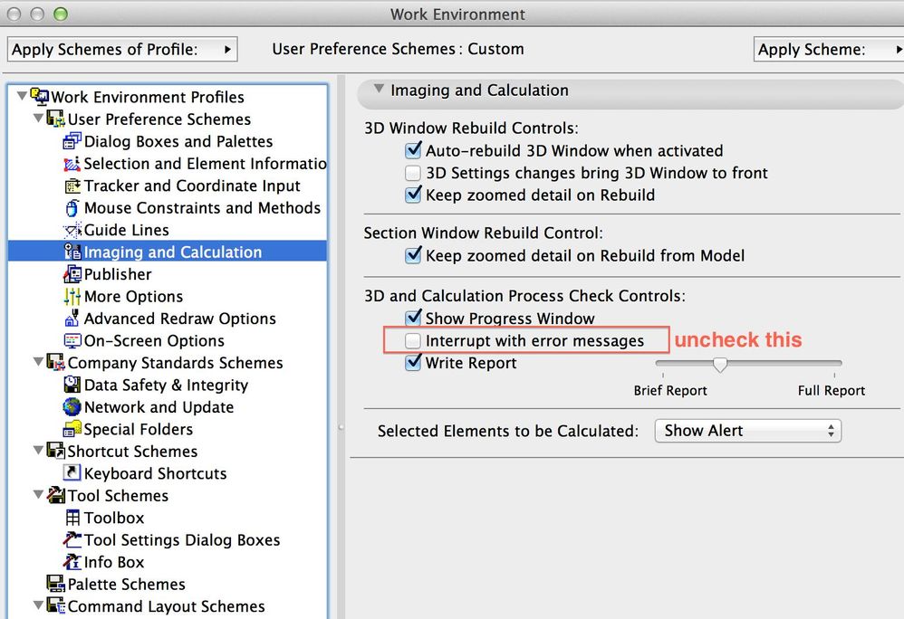

Is this kind of error gonna cause me any trouble getting renders in archicad or any other program like artlantis or V-Ray?because when I press continue on all of the errors everything seems to be ok as long as I'm still in the 3D window.
David Shorter
With errors which allow you to continue by clicking OK you can change your work environment, Imaging and calculation, interrupt with error messages. Uncheck this and minor errors will be ignored.
Always useful to do this if creating a fly though or a render which will run overnight
Hope this helps

you said" Uncheck this and minor errors will be ignored."
what did you mean by uncheck?how can I uncheck it and have the minor errors ignored?
David Shorter
Its in the Work Environment, see below
