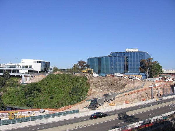

does anyone know how to put the 3d model in the real world photo at the right position. I have a new building and I took a photo from the site at the corner angle, How could i put in right position to match the photo
