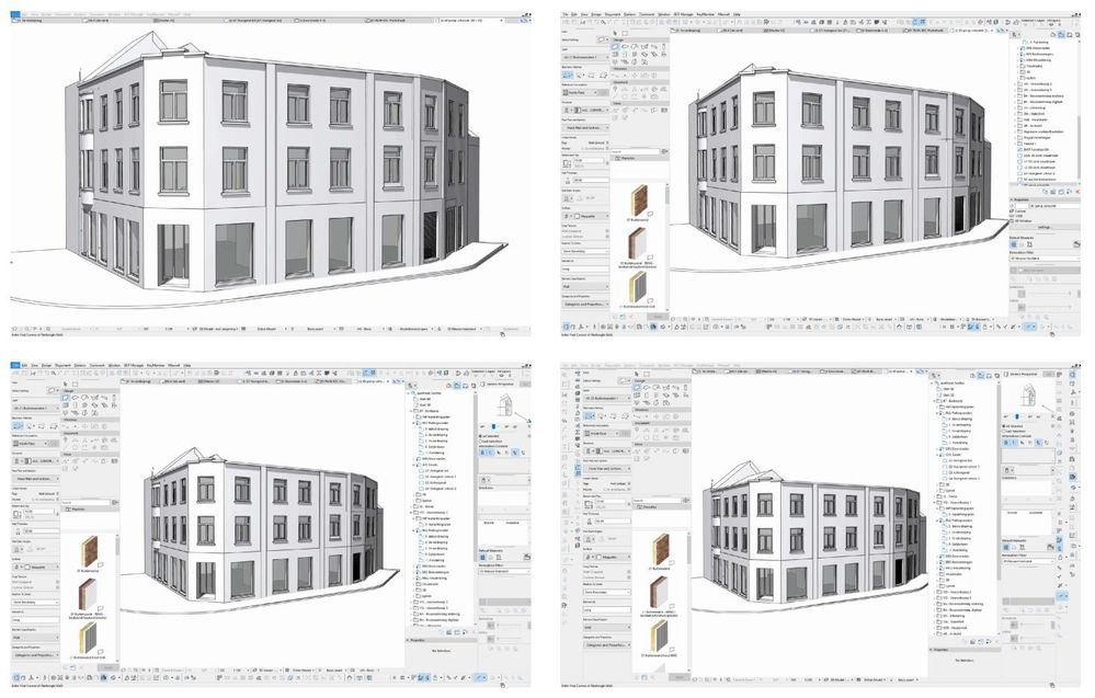

The zips might be a bit too complicated, here's a jpeg with the 4 workspaces.
Low res, but clear enough to get the idea..
And here's my current workspace with the toolbars grouped by theme.
I would like to add one column at the right, so I have the viewport centered, I need less scrolling in the navigator because it is full height (an issue with renovation projects) and I add can extra pallettes.

As you see on the picture, 32" 16:9 has less pixels, but is a bit wider than 30" 16:10. The benq monitors with eye relief features and CAD mode might be a good choice in that size.
