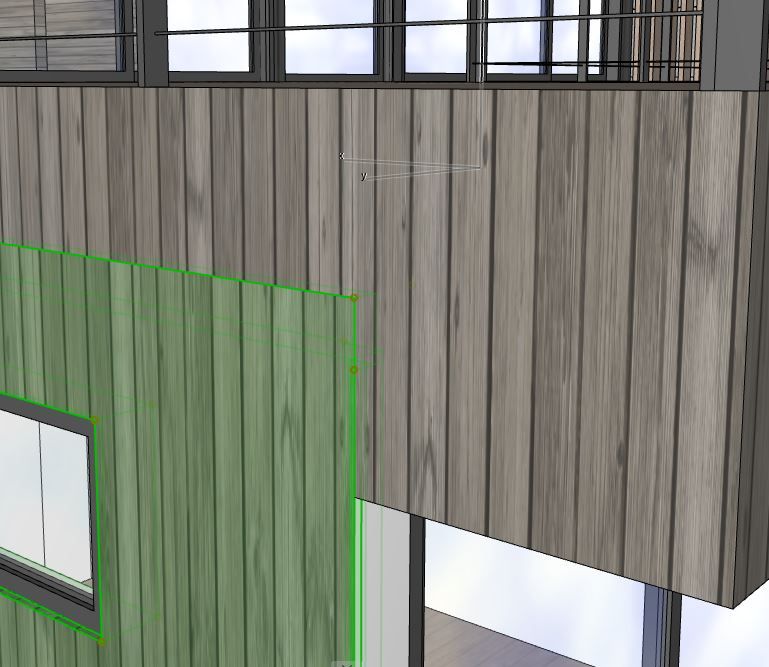

Hi Barry
I am 100% sure I am selecting the exact same spot. See attached screenshot where I have isolated the two slabs in question. I am resetting both slab's origins at the same time clicking on the corner spot where the purple circle is. See attached.
Prior to that I reset both textures as well.

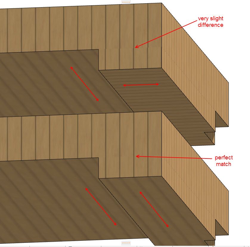

I don't have exactly the same texture as you but I did see the same problem.
What I notice is the direction of the texture in the plan surface is different for both slabs.
Changing the direction fixes the problem.
Select both slabs and use "Set Direction" by clicking on the underside (or top) of one of the slabs.

Genius!!!!!!!!!! Thank you very much.
What on earth could be the reason for this? Surely the top surface should not affect the side surfaces and vice versa.

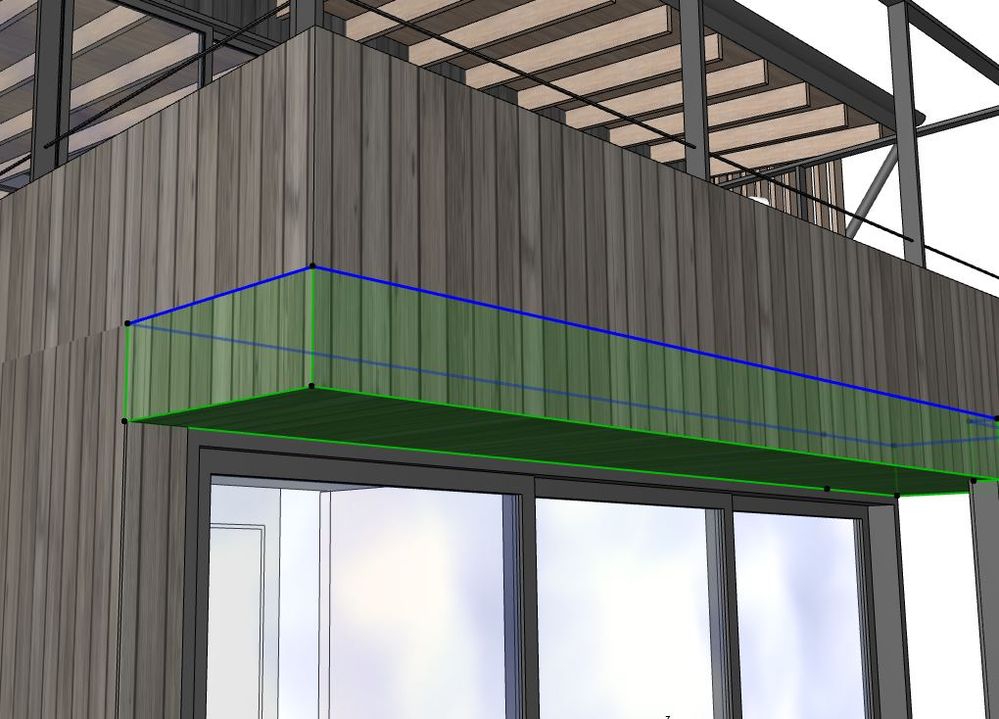

Now that you have solved the issue of the two slabs, I'm wondering if you could shed any light on this one...which is that I cannot align the texture of the wall under the slab. See attached. There is no "top" surface as such for the wall so i'm not sure what I can do to make this align. I have tried resetting texture, setting the same origin with everything selected, flipping the wall, to no avail. I have also drop-boxed this here:
https://www.dropbox.com/s/d7ak9tcmqvzgwxc/3D%20textuer%20issue%202.zip?dl=0
I have included the jpeg of the texture for you.
Sorry - I should have included this query in the first post as well.
You can either rotate the wall texture by 180° or rotate the slab (all slabs) texture by 90°.
I am not sure why but it seems that the origin is moved slightly for different rotations - even though the same starting point is chosen.
I think the problem is exaggerated with your texture because the start and end planks are cut in half but are not exactly the same width.
So when the texture is aligned one way it will be in a slightly different position when rotated 180°.
