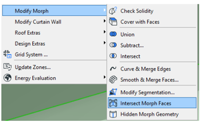

Hi folks,
I did not get ‘Intersect Morph Faces’ command to work when I am trying generate the edges at the intersecting faces of the selected morphs.
I am using Archicad 23. (Design>Modify morph>Intersect Morph Faces).
There seem to be no edges generated after I applied this command. I had picked up the morphs with one single selection.
I am wondering if I missed anything.
Thank you.
1 Reply 1
DGSketcher
Legend
@Reysol That command works on a single morph only... [HELP]
If you are intersecting two or more morphs then boolean operations may be more appropriate... [HELP]
