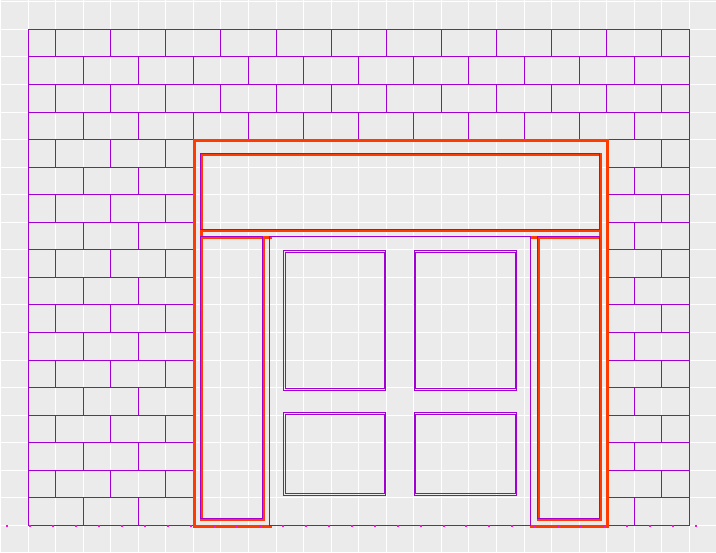

But, we seem to be having trouble with the new Doors (Which we love!). Maybe someone out there can help.
The Problem:
In Plan view the Doors are showing a heavy line where the Wall has traditionally healed itself. The current result looks messy.
Also, in Sect/View the Door/Glass/Trim Lines are not able to be modified individually and so we are getting everything the same lineweight. This in and of itself is not a big issue, BUT then the Frame is surrounded by a Partial line that starts and stops at the side of the Panel opening. Also it omits the line separating the Panels.
We would appreciate any insights.
See the attached images for our current Plan & S/E Representation.
