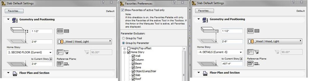

Hotfix 2 definitely has a bug in it relating to levels.
For example, create a slab and save it as a favorite. I created a desk surface and had it set to be placed on the current story 2'-6" above the current story.
Under "favorite preferences" I have checked the boxes so that the "home story" for all elements are not save with the favorites. This has worked perfectly for creating my wall favorites. The wall will then always be placed relative to my current story. However, with the slab favorites the slab story placement wanders.
If you now create another slab favorite (it can even be the same slab with a different name) you now have two favorites to choose from. If you initially place a slab using the favorite settings it works fine and can be placed relative to any story you move to.
However, if you choose the other favorite and select the original one again the slab will now be placed on the story below. In fact, each time you select another favorite and come back again the slab is placed down an ADDITIONAL story. (i.e. -2 the second time, -3 the third time, -4 the forth time.) My slab favorite setting eventually placed a desk slab down 400ft in a story I use for some 2D details!
Conclusion, My slab favorites are not currently useable. I assume others are having the same issue?

Hi All, this was a bug that has been fixed fin AC17.
Despite of unchecking (or keeping unchecked) "home story" in the favorite preferences, the home story was not kept for some elements.
It was kept for these elements: wall, column, zone.
and didn't work for these: beam, obj/lamp/stair, slab, roof, mesh, shell, morph.
If you are still experiencing the problem, please install the latest AC17 update.
