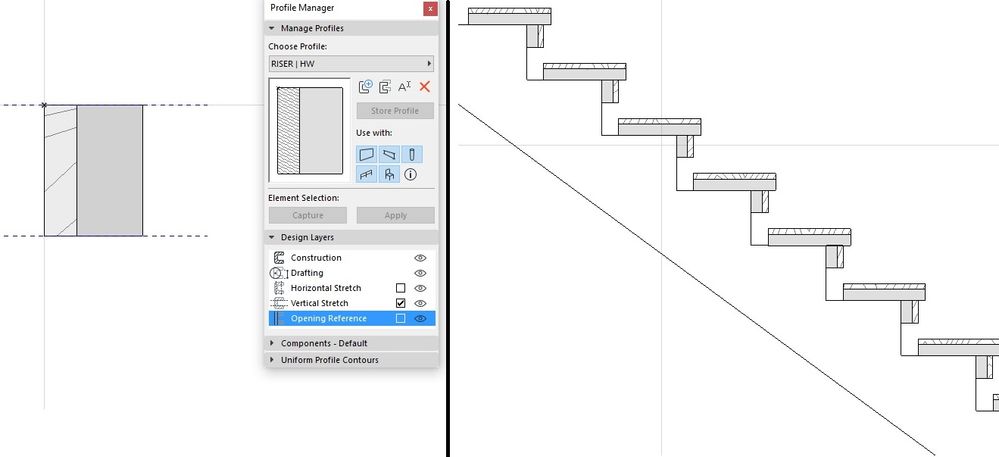

Is there a way to use Profiled Risers and automatic riser height in the stair tool?
I've got vertical stretch lines in the profile, but my risers will only use the set profile height.
2 Replies 2
I believe this function has not been coded into the Stair Tool so the answer is no.
Please make a wish for this so we can vote on it and submit it for GRAPHISOFT to consider for the next version.
If you make a wish, please post its link in this thread.
