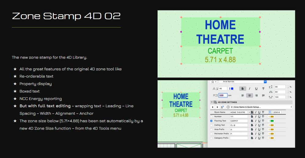

Lingwisyer
Guru
The Zone Marker from the 3rd party 4D Library has a bounding box which you can adjust to list the length and width of a room. Unsure if @Ben Cohen has made a Zone Label that does the same thing. The issue with this is that rooms and in-turn Zones are not always rectangular...

MitchD
the 4D Library is a complete library for purchase... it's bloody awesome however, well worth it for our office.
