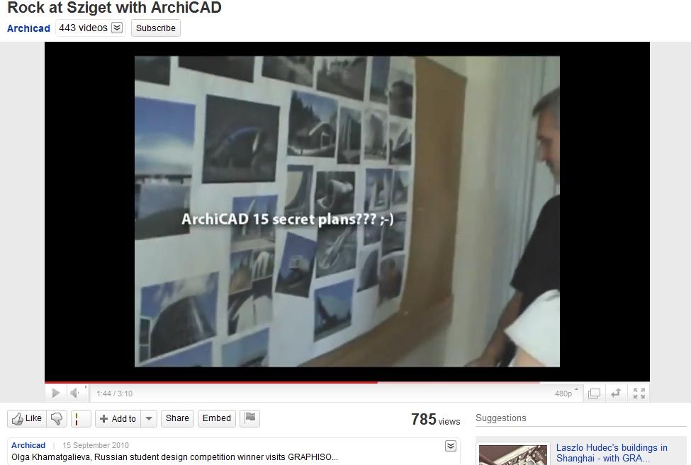

At 1.44 on this official Graphisoft video about a competition winner, I notice they flash up a view of a board showing lots of curvy-blobby architecture, with a tongue-in-cheek caption of "ArchiCAD 15 secret plans???;- )'"
Now, it's unlikely they would have done all those actually in ArchiCAD yet, but why would they have an ideas board full of curvy buildings when we know ArchiCAD doesn't do curvy stuff very well? I'd guess they must be seriously thinking about it at the moment.
http://www.youtube.com/watch?v=AezIxlBpSu8
