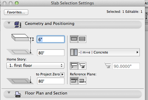

Eduardo Rolon
It should not do that. Fo example:
1. 2nd Story at 100' AFF
2. Move Slab -20'
Eduardo Rolón AIA NCARB
AC29 US/INT -> AC08
another Moderator
Eduardo Rolon
Use Relink Home Story to assign it again to the second floor.
BTW this is all done in the 3D Window
