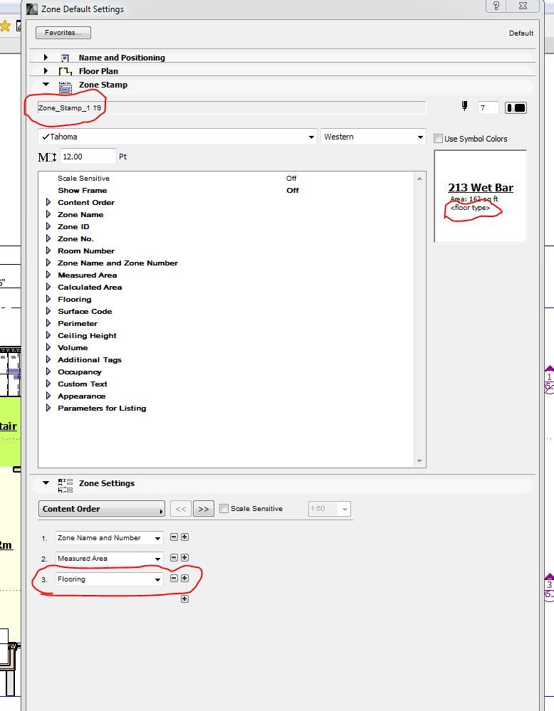

Are there no other options for zone stamp in AC 19? I prefer to use MasterScript Total Zone, but the "load other zone stamp" option appears to be missing in 19.
If I'm stuck with the GS zone stamp, how can I get it to list the floor material for each zone? I see it is an option in the zone settings, but where does it read this parameter from? Does it pick up the surface of the topmost slab? Or must I fill this in manually for each zone (which kind of kills the BIM aspect)?
You can change the Zone Stamp in Zone Categories..., you should find it with the other Attributes (Surfaces..., Line Types..., etc.).
