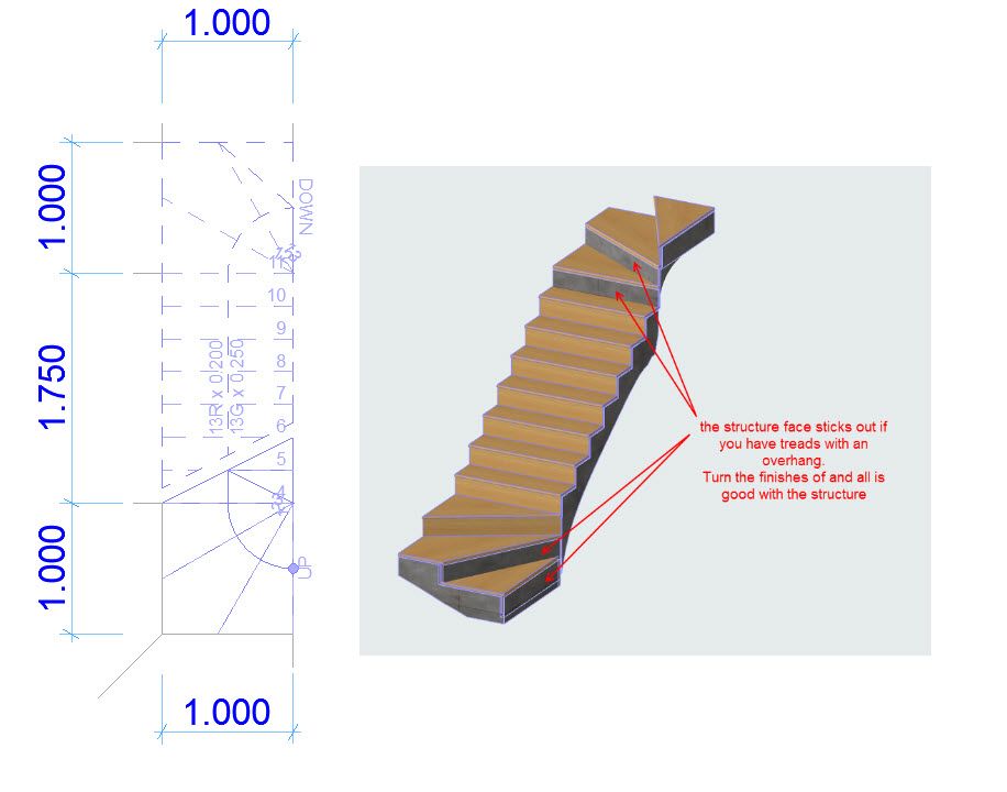

The final result.
If you have tread and riser finishes you will get a false face on the structure.
But then with these zero spaced winders you probably wouldn't have treads with overhangs.
