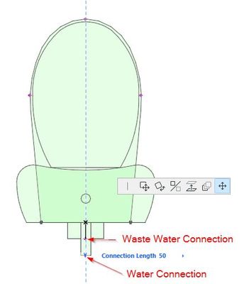

Hi @Guillermo1
Both connections have their magenta hotspot at the same position in the plan view, so you can move the water connection and the waste water one independently. Anyway you can also change the exact connection length for any of the systems in the Settings Dialog (Ctrl+T).
(Check the attached video)
Ricardo López, M. Arch.

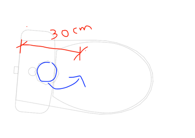

Guillermo1
Im refered to this , in the floor plan,

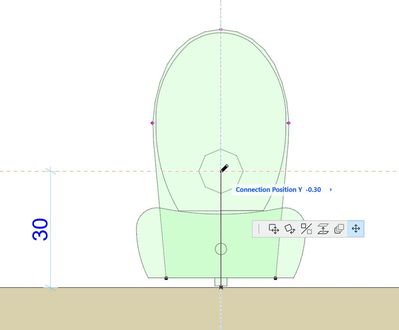

Ricardo Lopez
Hi @Guillermo1
The easiest way is to draw a guide or a temporary line as a reference and move the magenta hotspot.
Guillermo1
as object it works, but when it converted to equipment lost the hospot mobility, i guest gonna let it as an object
