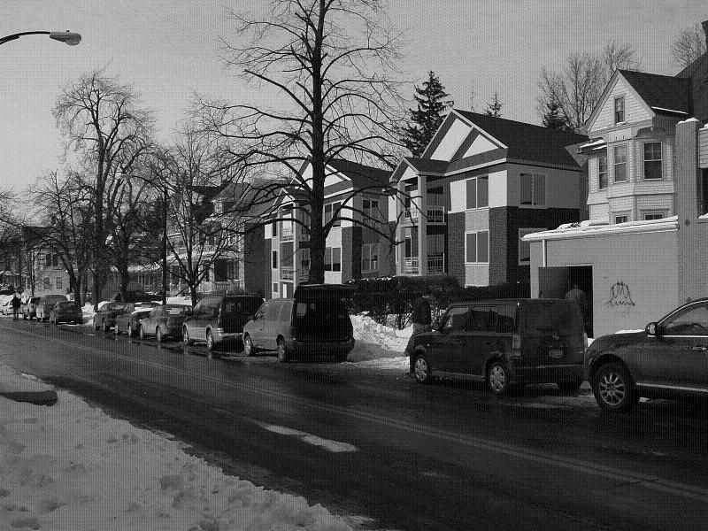

Thanks alot for the great advice guys.
Heres the end result, one of the big problems I had aligning the rendering was the project had two structures sitting on one lot so It was near impossible to try and match up the perspective of the distance between the two structures of the project and then between the two structures next to the project. So i just rendered each structure seperatly and place them in photoshop. A little distortion but the visual is there for the client. Thanks again for your help!
Here it is.

Nicely aligned, and I like the use of grayscale to improve the blending.
At the posted size, it's great. If the client result is bigger, you might want to adjust some of your Lightworks settings. I notice that the real shadows are very soft, but the model ones are hard. Use the 'Real Sun' with more angles, and perhaps boost the ambient relative to the sun. Might need or want an 'undersun' to illuminate the soffits. Search for Dwight's various posts if you do not own his LW in AC book.
For blending a row like that into a photo with adjacent buildings, you kind of need to have had the surveyor mark the corners of the existing buildings and you or he/she measure a particular wall height. Then model that portion of those buildings, perhaps even just with columns, and use that for the alignment. Then hide the layer those alignment objects were on before the final render. Idea for the future - obviously you've nailed it here. 😉
