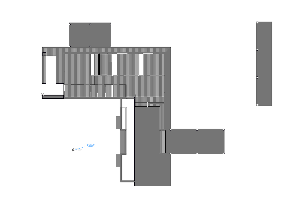

My RCP (3d document view) looks like this - I dont want the ceilings to show grey like this, i want the drawing to appear as a 2d drawing. how would i fix this?

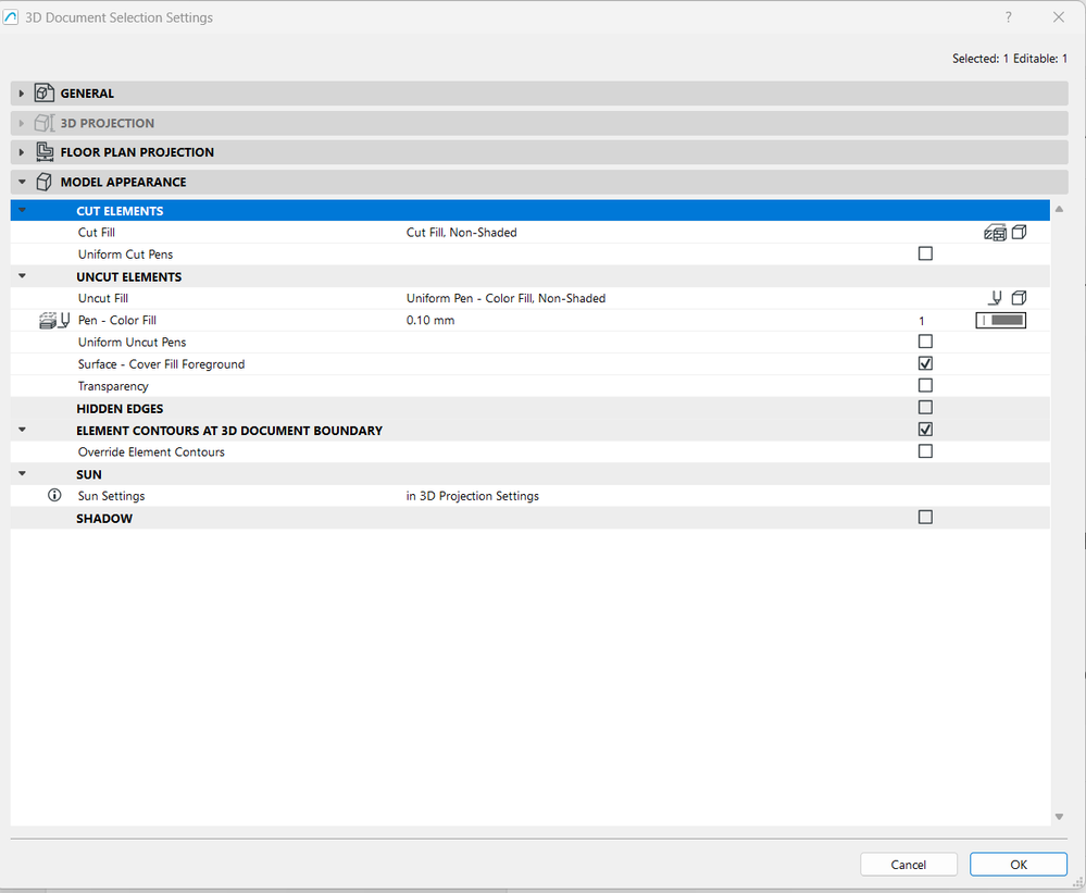

These are my 3D document selection settings for this view.

Your uncut fill is set to 'uniform pen', which is fine but the pen is set to grey.
Try setting the pen to the transparent (null) pen.
2026-09-18 02:34 AM

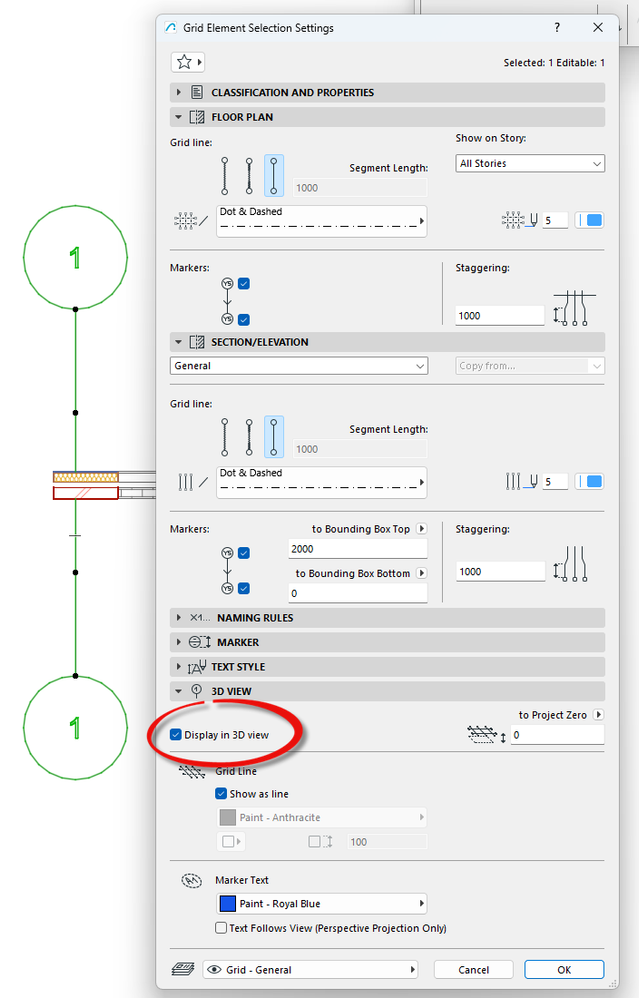

Just another question:
How would I get the grids to show in this view?
2026-09-18 03:40 AM
I don't use grids, but it looks like you need to make sure they are set to display in 3D view.
