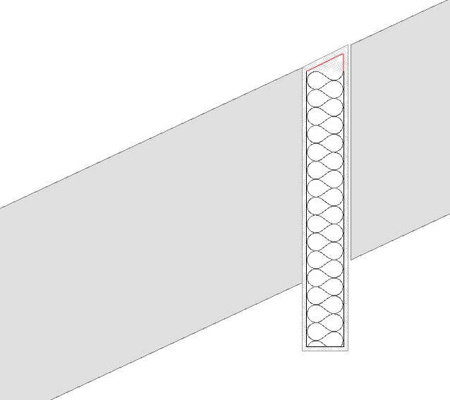

In my project there are a few composite walls that should finish with an angle, therefore I was hoping to use the wall finish tool in order to make the floor plan representation to look correct. I didn't find a way so that the finishes and core have the drawing as in the image, is there a solution to this?

Have you tried a custom complex profile column?
JonasRC
That's a solution, I thought maybe I was overlooking something in the Wall Finish tool, thank you for the idea!

You are not overlooking anything.
There are wall ends that will wrap the skins, but they will always be square.
The shaped ends are basically just shape blocks tacked on th the end and will not wrap the skins.
Complex profile columns is the way to go.
