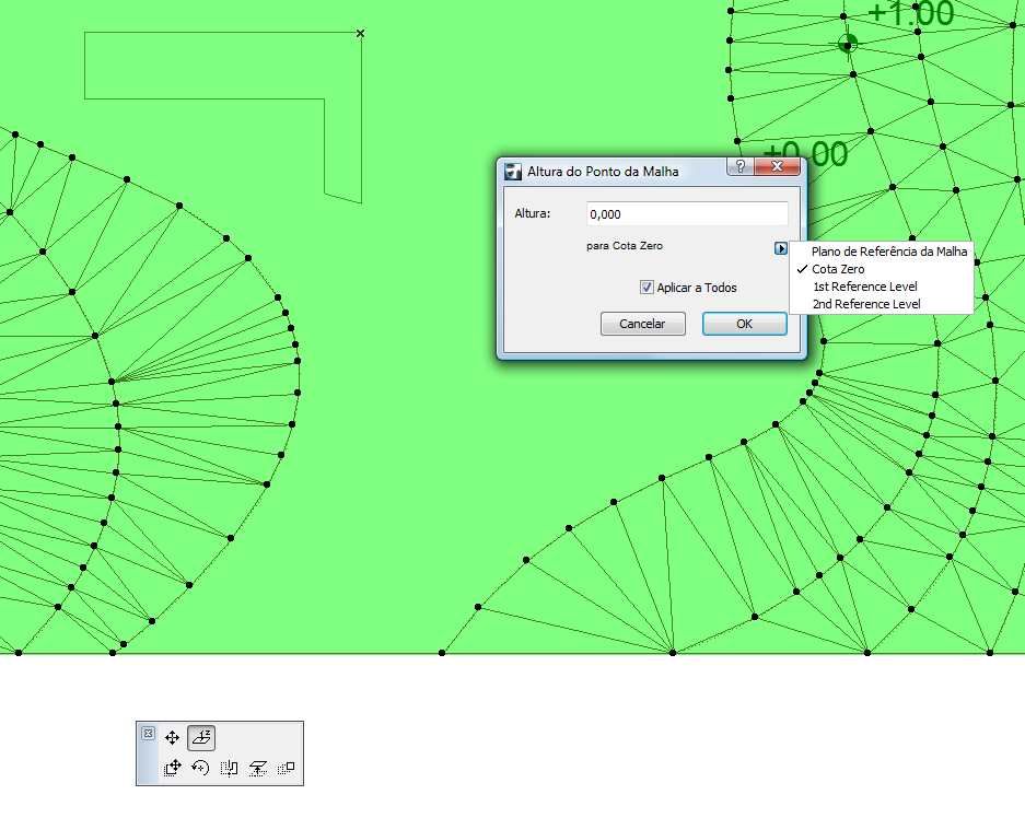

I tried to create a mesh from a 2d drawing, following the advanced modeling tutorial. However, the elevation between 0.00/0.00 is incorrect (it should be 11m).
What exactly have I done wrong?

It seems that your mesh is down 11.00 meters from the project zero origin...
also be sure to use the correct reference (small triangle next to the z value in the mesh pet palette) when you input the levels.
