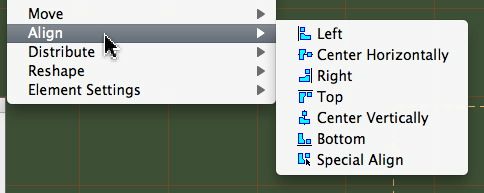

These are the limit of our align tools.
Special align gives you what you want, i think.
