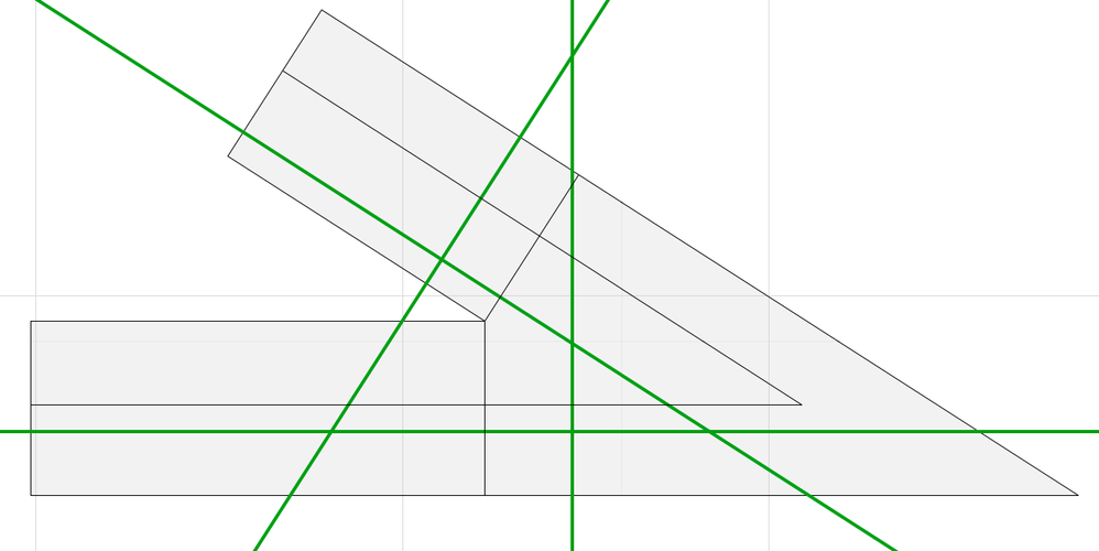

What is the best way to model an angled staircase please?
I.e. the flights are standard but the landing is at an angle (a variation of an L-shaped stair with a wedge shaped landing)

If your 'L' shaped stair object does not allow you to adjust the angle of the landing then you could either use separate stairs for each flight and add your own landing.
Or use the 'Create stair using selection' command (Design menu > Design Extras) where you draw a fill the shape of the staircase and a line for the walking path (and I think an arc for the landing walking path). That way you should end up with one complete stair in the shape you want.

Attached is what I had created from the 'create stair using selection' tool before your reply, together with the fill/lines that it was generated from.
Can I adapt the staircase after it has been created?
For the other option, with two stairs and a slab as a landing, how do I change the riser numbers please? What impact does it have on railings?
Fill on floor plan (didn't realise you can only add one attachment)

I have never had much success with the old stair tool (especially the create from selection) except for quite simple stairs.
To avoid the steps in the landing you will want to use a slight curve for the path (see attached image).
It may not work still - you might have to adjust the positions of the curve starting point - I kept getting one step in the landing but don't have time to seriously test it sorry.
The shape of the stair can't be adjusted afterwards but you can choose to "edit" the stair (button in bottom left corner of stair settings dialogue), where you can change some of the parameters.
