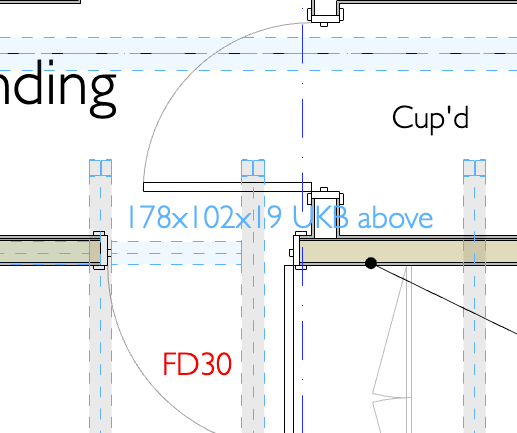

In a project I am working on, we are trying to show the beams overhead on the floor plans in a transparent blue. I am using the Archicad Universal Beam in the Steel structure section of the standard library. Level beams display correctly (faded blue fill with dashed blue contour line); but when I change the rotation angle of the beam along the cross section to follow the roof angle, the fill changes to a grey. If I were to change the angle back to 0 degrees, the fill returns to blue. Please see the attached screenshot showing both the blue level beams, and the grey rotated beams.
How do I get a beam which has a rotation along the cross section to use the correct floor plan display options? I am using Archicad 24 7007 UKI Solo.

It is probably just the way the object is scripted.
When flat is is just a simple lines and fill scenario (contour pen, hatch foreground pen and hatch background pen).
But when you angle it, it will use a 'Projection' of the 3D view in plan.
I just had a look at it and it seems when angled, you can only use the backgound pen colour and the contour pen colour is used for the foreground fill as well as the actual contour.
So you still can get the same fill so long as you set the contour pen from grey to blue.
As I said probably a limitation in the way the 3D projection works (it's a GDL thing).

There's not a problem with the beam tool - but the beam object is incredibly useful with all of the BS beam sizes readily available I was hoping there was a solution available to enable me to continue using the object.

Many thanks Barry, this makes sense.
