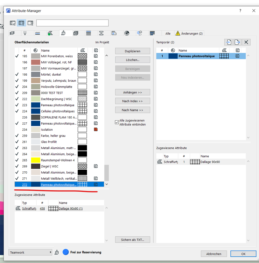

I imported some surface to Archicad 25 and would like to change its original texture jpg a bit. Where do I find this texture jpg?

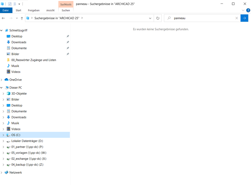

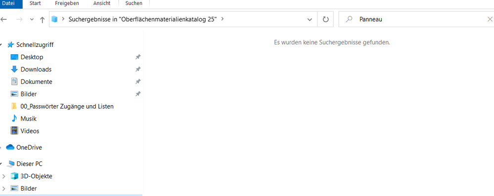

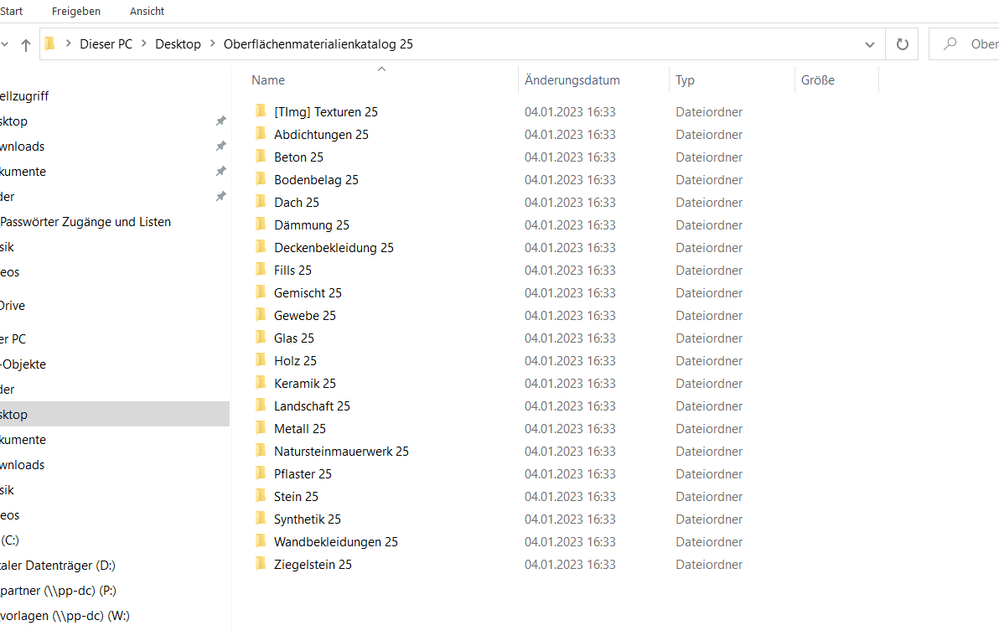

I extracted the Archicad 25 library, but is not there. I also do not find this imported surface anywhere in Archicad 25 installation folder (so that I could extract that library surface part).
Anyone knows where are imported surfaces hidden? 🙂

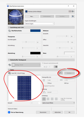

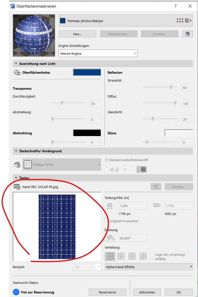

If you click on the 'Browse for images' button, you will see the path to where that texture is located.
That button is greyed out for you as you seem to be using teamwork, so you will have to reserve the surface for editing.
Also it will be in an LCF (Library Container File) so you will need to extract (expand) that library file before you can edit it.
