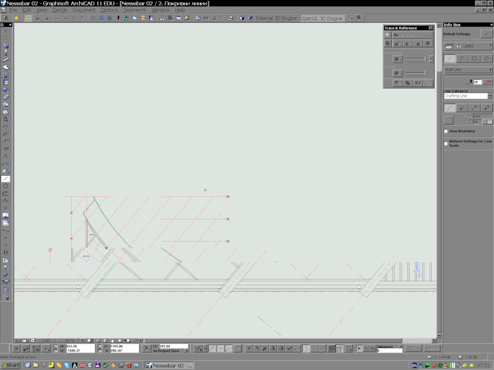

There is another AC11 bug. I just don't have enough time to post them all to the forum! This is how my screen looks from time to time. I suppose it has something to do with my graphic card, but it runs flawlessly with AC10 an AC9 on the same computer! So, let's not blame the card!
I will post some more bugs when I find time to open AC11. Now I am migrating my current projects to AC10, otherwise I will not be able to finish them on deadline!

The display bug might be related to the bugginess of the new "Trace-Reference" tool. My office uses very good graphics cards (nVidia QuadroFX 3500) and we have experienced display quirkiness when the "Trace-Reference" is activated. Be sure to log your bugs with GS tech support and/or your reseller so GS can prioritize the issue.

Klimet, did you switch off directx display in the regedit file?
For me after dx switching off all display fine.

please find a link http://www.archicadwiki.com/DirectX . My computer with ArchiCAD instalation have integrated graphic on the board (Abit nF2 nview, GeForce 6150), so you see it's basic configuration, but all working fine for me. Of course at first I upgrade my graphic card driver and switch off directx.

I think that NVIDIA cards 6 & 7 series s*u*c*k.
There is a significant downgrading (huge delays) of 2D refresh on XP (panning and zooming) with NVIDIA 6 and 7 series when the organizer window is on.

well 6600GT was one of the worst graphic cards for archicad. also it is a good idea to have a fresh windows installation if you have a long time since you have installed older versions of AC. unfortunately windows can get messed up by it self if they operate for long time. When you install a lot of software and especially software that use almost the same libraries like you have AC 9-10-11 the it can mes up easier.
