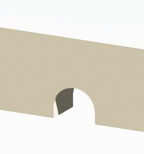

I'm drawing an old masonry fort with lots of vaults, etc. The first image is the model view of the parade side. As you can see there's a large vaulted opening in the front wall.
In the second image (next post) is the plan view - and the wall appears solid despite the fact that it's been cut. I've set the floor plan cut plane to 3', which is definitely below the arch. Why is it still showing solid?

Link wrote:
And if that doesn't cut it, you could always leave the SEO there and just insert a short empty opening the same width as the SEO, so it shows up in plan.

Zolli wrote:
Looks to me like the arch is not exactly an "arched opening" in a super-thick wall. If it were, it would probably show up OK on the floor plan with the wall displayed as "symbolic cut." It appears that you're using some sort of curved roof object to make the arch and/or using solid element operations to produce the archway. That's cool and all, but in plan view it would probably produce a result like in your second image.
Though I wouldn't recommend this universally, you could try raising your cut plane to 4' or 5' to see if it shows up....
In any case, if you haven't already done this, I would suggest that you model the wall that the arch is in as being 6' thick (or however deep the arch is) and insert an arched opening (it's a door type) into the super-thick wall.

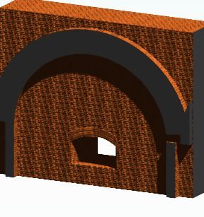

Several peeps recommended using the window/door opening and I tried that. It's appealing because it would be easier AND might cut down on the file size. So I tried that.
Unfortunately neither the arched window opening nor the arched door opening allows you to specify the spring point of the arch nor the radius - or if it does, I don't know where to find these. Also, it doesn't show the thickness of the masonry arch - it's really an outline opening.
The first view shows an SEO of the rear wall. You can see that it's a relatively flat arch using 2 courses of brick. Also the side walls of this opening are skewed (it's an opening for shooting a cannon). I do the SEO then add in those side walls as a separate item.
This was a test to see if I could simplify this thing and just use an arched opening - but as you can see the radius and spring point of the arch don't correspond to the real arch. Or I just don't know how to do that.
I sure wish it would work this way because to build this thing to be the way it's supposed to be takes a lot of pieces and parts.
True. A real problem sometimes. But if you want to re-use this assembly, you should save a lot of time by making your own custom opening (window/door). The procedure is described in the docs (Help menu) and has been mentioned several times the last week.
