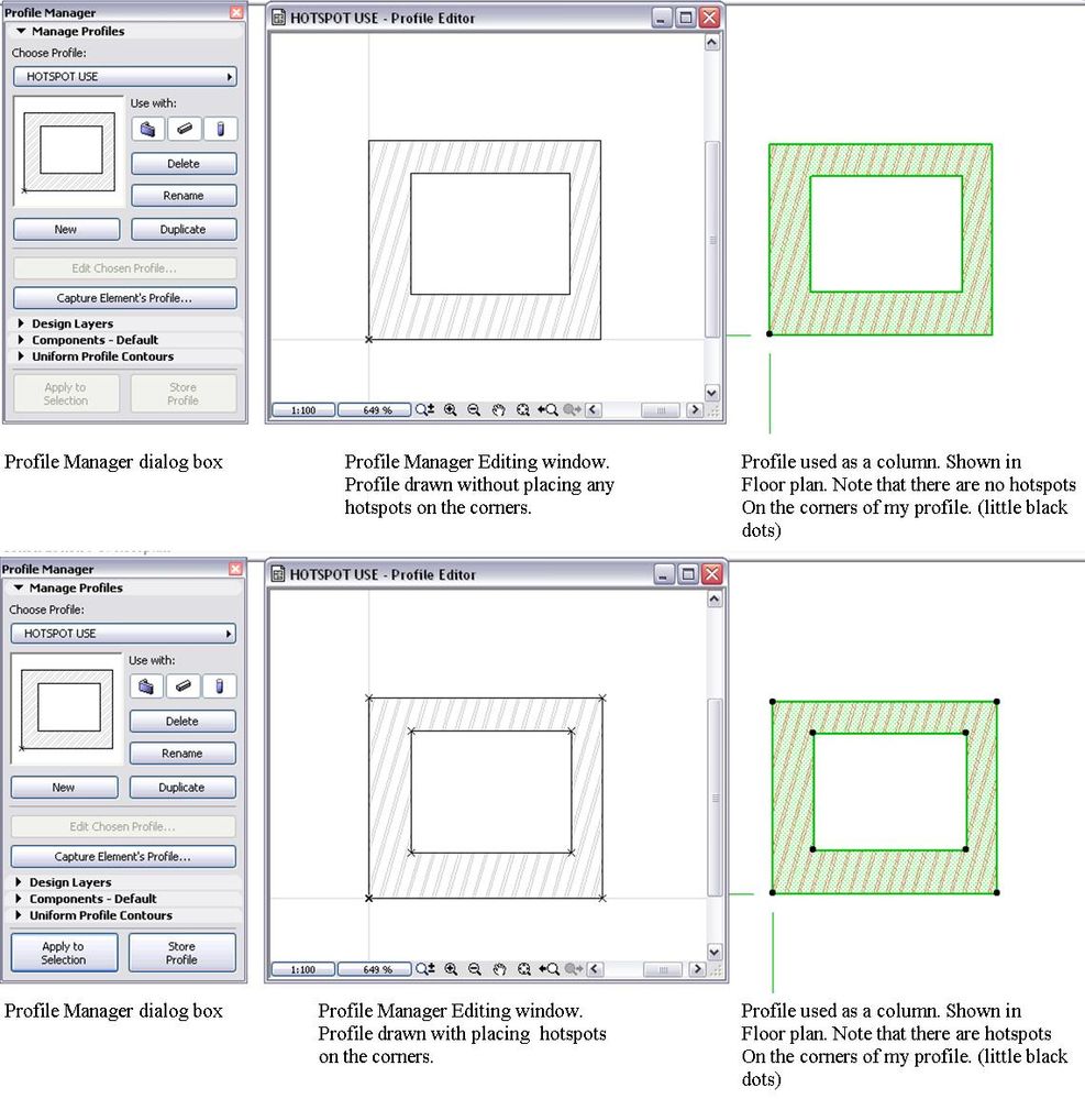

I find that using the hotspot tool with the Profile Manager helps alot.
I added a picture to try and explain what i mean. Hope it helps.
You can also use this to make extra hotspot on gdl objects that you have created.

@cecilia
Nice information.
You are so beautiful.

Nice screenshots and examples, Cecilia!

Yes, thank you all, especially Cecilia with the beautiful image. (Easy there 77 - down boy! )
