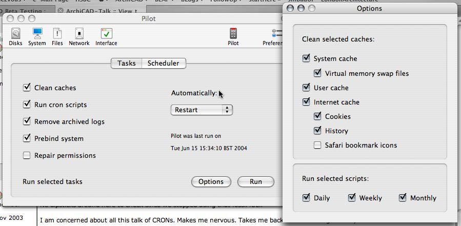

Here is my observation of this patch. It is slowing me down. Everytime I open a dialog box for an open save and try to navigate around my hard drive, it takes a long sip on the coffee to get my window to update.
I believe this slow down to be a problem of AC 8.1v2 2284. Is anyone else seeing the same slow down?

when was the last time you:
repaired permissions
cleaned your caches
ran the cron scripts
updated the prebindings
all of these things need doing periodically, in fact the cron scripts are periodic cleanup tasks that run in the middle of the night - but only if the machine is on and awake.
and if these aren't done regularly or after major installations and updates, they can all contribute to slowing the machine down.
as a general rule, i repair my permissions using apple's 'disk utility' after every installation that requires an administrator password, (it means the installer's been messing with the system's or machine's library).
there is a shareware utility called cocktail that performs all of these tasks (and more) from a simple GUI. a better explanation that i can give here about OSX maintenance can be found on the o'reilly macdevcenter:
http://www.macdevcenter.com/pub/a/mac/2003/11/21/maintenance.html
it's an excellent article that every mac OSX user should know about for smoother and faster running of their machine.

this was exactly my point: installers and the like that mess with the system library permissions slow the machine down generally not necessarily the application. you're getting the slow down at the point archiCAD starts using system resources for a task, right?
open apple's 'disk utility' in the 'utilities' folder of the 'applications' folder. click on your hard drive in the list on the left and then click 'repair permissions. let me know what happens after you've restarted the machine.
there is one more thing that i am aware of that can cause network slowdowns, but i don't want to go there just yet - let's do the permissions first.

i've never used this 'onyx' app, but you can give 'cocktail' a go without paying up front. if you do decide to try it: click the 'pilot' tab along the top, check everything except 'repair permissions' (i always prefer apple's apps to handle this even if they do get their permission information from the same file) and then hit the 'run' button. you may want to check in the options tab first if you don't want to lose safari's cache and favicons . . .
i generally run cocktail with the options that you can see in the image below and set to auto-restart. i then use 'disk utility' to repair the permissions straight afterwards and restart once more.
let me know how it goes . . .
