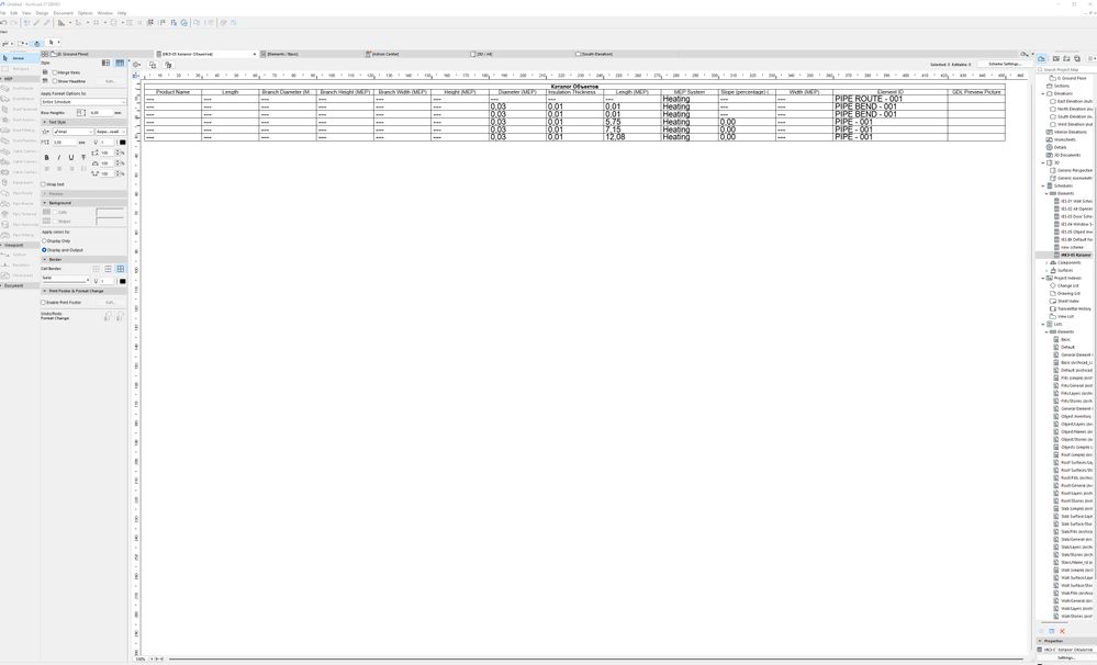

Hi @masterslug,
In Archicad 27, we revamped the underlying architecture of the MEP functionality to facilitate the development of a more advanced and current MEP solution. We also unveiled a new routing tool that enables swift and straightforward modeling, along with a seamless editing experience.
Regrettably, this was a substantial undertaking, and as a result, we had to omit the scheduling functionality in Archicad 27. However, we have since reworked and reintroduced this feature in Archicad 27.2. Therefore, once you install the update, you should be able to generate schedules using the relevant information from routes.

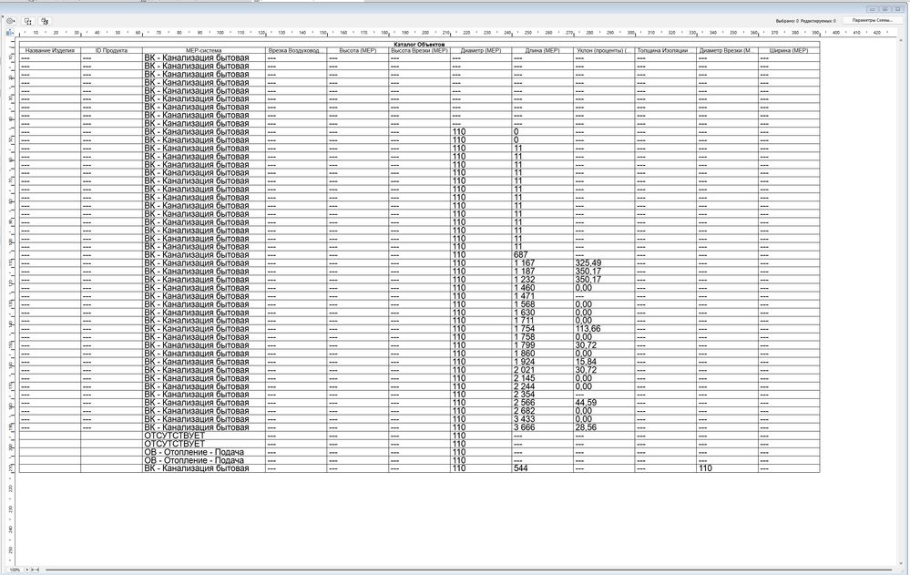

Hello. I have the "Archicad 27.2" update installed. And I can't get the name in the catalogue. Like any other parameters except those highlighted in red. How do I infer the name or other parameter from a library element?
2024-05-16 01:15 AM
You can get it with API and write their values to properties. Properties can easily add to catalogue.

2024-05-16 08:38 PM - last edited a month ago
I added the ability to read MEP parameters to my addon, especially for the example. You can do the same using the code from the API examples.
video review:
pre-release version addon for test :
https://github.com/kuvbur/AddOn_SomeStuff/releases/latest
