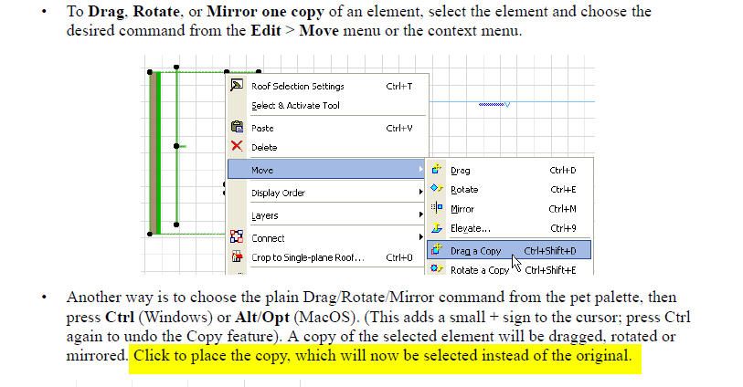

So you are saying then before 19 if you were to drag a copy of an element that it would not remain selected after the copy but it does now in 19?
This is odd to me as no matter what I try it remains selected in all versions I have back to 12.
The attached is taken from the version 16 reference guide.
I am not aware of anything that will change this behaviour.

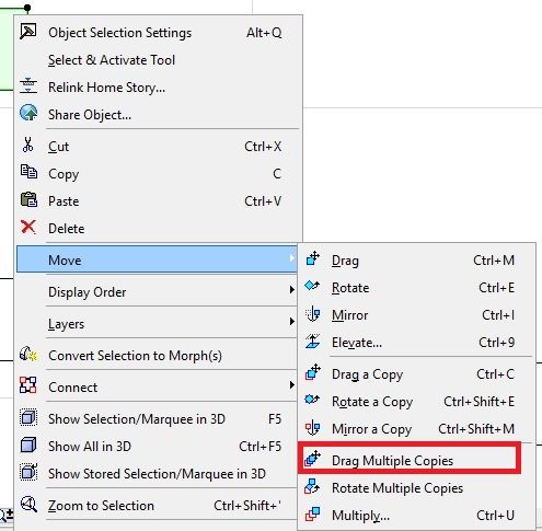

haidu_bogdan
I somehow solved it.
It seems that a the command drag multiple copies has this new error in archicad 19. If I use the simple drag a copy command then I don't have any problem. If you say you had this problem since A12, then there might some differences between the mac archicad and the windows archicad, as I use it on windows.
It was very annoying at first as I always use custom shortcuts, and I even forgot that there were too copy command.
Too bad the multiple copies command got broken, it was much faster to use it when working. So now there are not keeping too their new motto completely .
Thank you very much for your help. I would report this bug, but I don't know where to do it. And I think this should be solved in the mac versions too.
Bogdan
The 'Drag Multiple Copies' when used from the pull down menus in 19 does indeed leave the copies and the original selected when you finish the command.
In previous versions only the copies remain selected - the originals are de-selected.
I hadn't noticed this before as I only ever use the keyboard shortcuts (start to drag and press ALT+CTRL).
This works as expected where only the copies remain selected in all versions.
The best place to report a bug is to your local distributor.
They should then help you to solve the problem (if you are paying the annual support fees) or pass it on the GS headquarters as a bug if there is no solution.
I report this as a bug to Graphisoft.
Both the Drag Multiple Copies and Rotate Multiple Copies command work incorrectly, regardless of how the command is invoked, by menu command, context menu command or keyboard shortcut.
