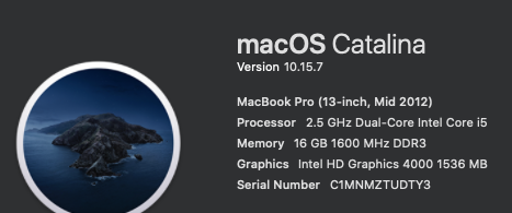

Vimi Rath
Hi.
I was using Archicad 24 on Mac OS Catalina 10.15.7. It was working fine. However, lately its been crashing the eminent I open any old files I have worked on. For new files, The moment I enter 3d mode, it crashes and closes. Can someone help. Also I would like to switch to Archicad 25 so will that work with this version of Mac. Also would like to know what is the optimum system requirement for a decent speed of Archicad and its graphics. Have attached my system configuration.
Your Graphics card may be the issue here.
I know nothing about Macs, but if this is a built-in card rather than a dedicated GPU, then make sure the Intel drivers are up to date.
I have no idea if Macs take care of this automatically or if it is something you have to do.
Archicad does not really like using just a built-in card.
I remember reading a post here somewhere where Minh recommends that the Intel drivers are up to date - but that was actually for a different problem - green lines on screen and I think it was a Windows PC.
I did find this post though that mentions crashing with Archicad 22 on Mac.
I am not sure if any of it will help.
https://community.graphisoft.com/t5/Setup-License-forum/Archicad-22-crashing-when-opening-on-a-HD-mo...
