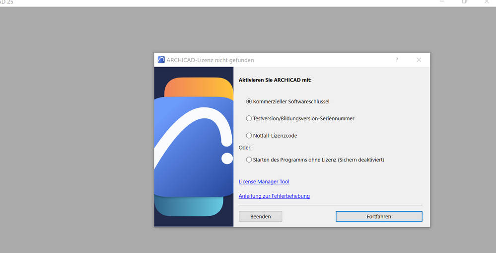

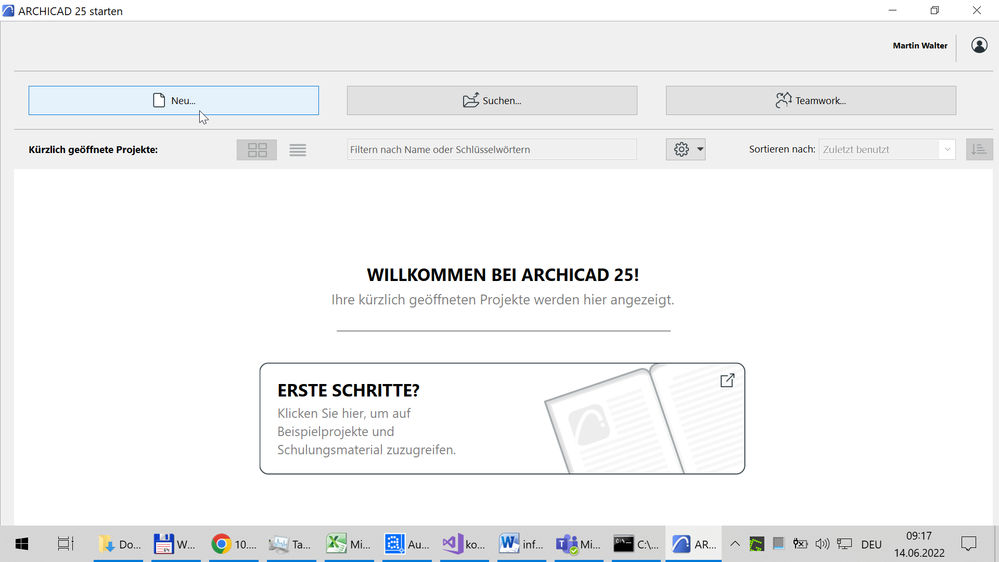

I have a Windows 10 machine. Till the last week Archicad25 worked.
But now after clicking on "new" project the mouse shows "busy" and nothing happens for 30 Minutes.
After 30 minutes it shows the dialog "license not found"
I already have reinstalled Archicad25 and done a Preference Cleaning

Yes, it is seeming to get slower and slower to start for me.
The start dialogue appears quite quickly, but pressing 'Browse' or selecting a file from the list, it takes minutes to actually start to open the file.
Then quite a long time to load the file compared to previous versions.

If you encounter slowness right after clicking New, it's likely that Archicad is having problem accessing the license. If you use only Single license (whether it's hardware-based or software-based license), it's best to set only localhost to the Server Search List of Codemeter:
  • Open Codemeter Control Center, then click WebAdmin on the lower right corner
  • Configuration > Basic > Server Search List
  • Add localhost to the Server Search List and remove all other entries
  • Click Apply
Also, make sure that Archicad is added into the exclusion list of Firewall or Antivirus program if it's relevant.

Martin Walter
Thanks for the answers. But the problem is still not solved for me.
I don't have a license for Archicad 25. I have removed all other entries from the server search list and added "localhost".
But I do not have access to the firewall settings or Antivirus program, because I'm not administrator of the pc
