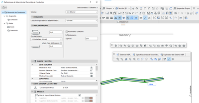

Jp1138
Dont you see this MEP toolbar in your program?
ARCHICAD 29 SPA (as long as the server works)
Windows 10

Hi Marco,
Thank you very much for the screenshots!
I think I see the difference now.
It looks like you're using the Legacy Graphisoft MEP Modeler, while I'm using the new native MEP Modeler included in Archicad 29.
My interface is completely different, and I don't have the "MEP Systems", "Route Specifications", or "MEP Explorer" toolbars that appear in your screenshots.
Could you confirm whether you're using the Legacy MEP Add-On or the new native MEP tools?
If you're using the native MEP Modeler in Archicad 29, I'd really appreciate knowing how you access that Route Specifications window.
Thanks again for taking the time to help!

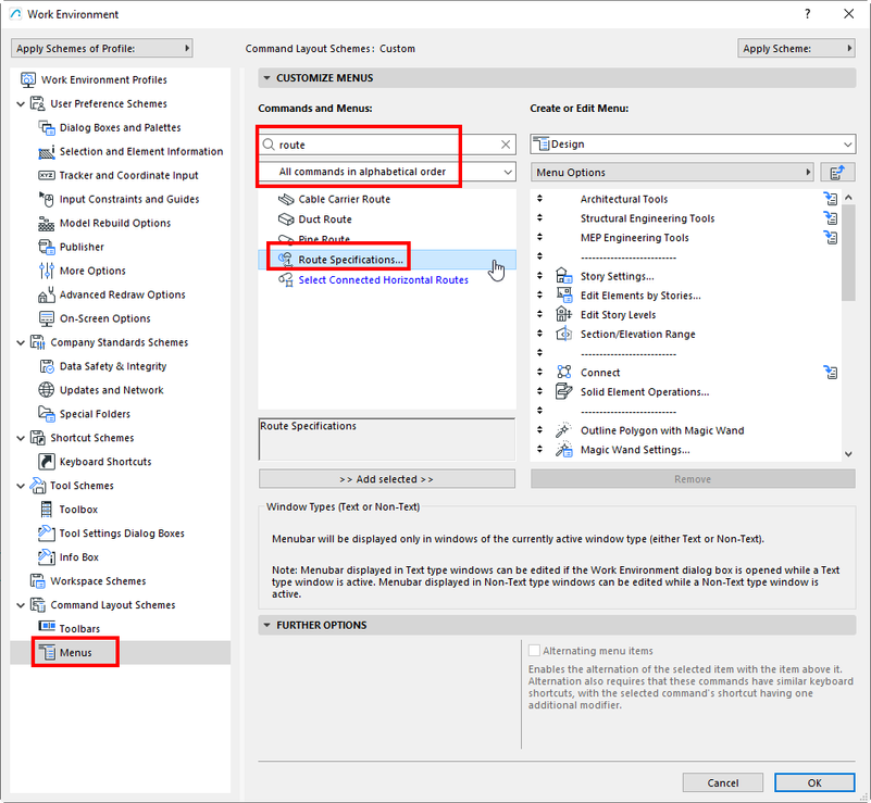

I think you just do not see the relevant menu command in your menu.
Go to the Work Environment, Menus page, list All commands in alphabetical order, an search for "route", then you will find the "Route Specifications" command in the list. Just add it to the menu of your choice.
Alternately, if you apply the "MEP Engineering Profile 29" Profile, the command will be there on the "MEP toolbar" toolbar on your interface.
