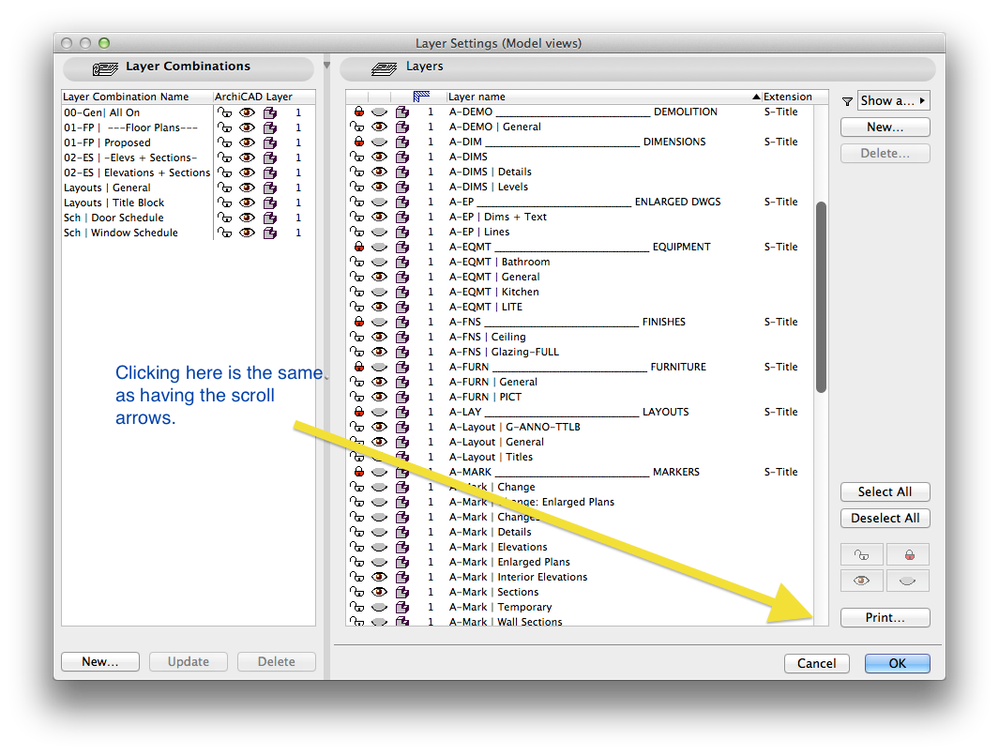

Since the first Archicad for PC, there is a very easier way to choose, or change, the layer of a component: a vertical cursor on the right of the list of layers.
In one click you go from the beginning of the list to its end, instantly.
With Archicad for Mac, this cursor is still missing: when you have to change the layer of a wall (for exemple), you have to scroll all the layers with the mouse wheel or with the arrows on top and bottom of the layers window.
If you have many layers, it takes a LONG time!
PC users save a lot of time.
I might be wrong but I suspect that this is a operating system-specific thing. If this is how every such list in every Mac program works, then it is a system function and all programs use what the system offers them.
There are various interface differences like this between the two platforms. For example, docking on Windows works differently from docking on the Mac.
Or the minimize, maximize and close buttons for windows are at different places on the two platforms. Or you can resize Windows differently on the two platforms.

Using the Shortcut fn - arrow key down or fn - arrow key up brings Mac users to the bottom or the top in any dialog.

The fn+arrow key is a good tip...unfortunately the fn key is not on every Apple keyboard!
You go instantly to the beginning or the end of the list and you must have super eyes to catch the right layer during the move.
You can have to manage more than 100 layers, when you get .dwg from outside.
The vertical cursor is very welcome then.

Also though Mac OS does not show them by default you have the equivalent of the scroll arrows on it. Once the grey bar appears you can grab it and move it or just click on the top or bottom to move one "page" at a time or "Option+Click" at top or bottom to jump to the beginning or end.
