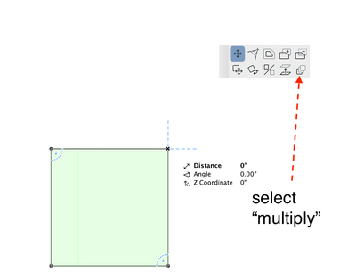

Hey everyone! I want to offset all tiles in my project by 5cm. Is there a way to do this at the same time? Because i have too many tiles in my project. Thank you all.

CTRL B repeats the last operation
Command on Mac, instead of CTRL, I believe?

Can you show an image of what you are trying to offset?
