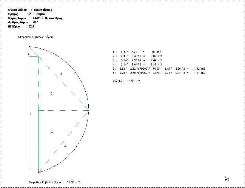

When i use the area list creator i get a result that i can cut and past in a drawing.
Can i change the font size? I always get a result usable only in 1:50 scales that are too large to fit in the drawing. and when i resize the drawing the result is too mixed up.

The area list calculator show graphically all the calculations required to calculate the area of a zone.
Can this be done with interactive scheduler?? I guess not
I don't follow you ... can you post a screenshot?
Karl
My version is in greek so i cannot tell you exacly how this is named in the english version but i post a sample capture from the output i get from area list calculation. The menu entry is just under the "construction simulation" entry in the caclulation menu.
Hmm. "construction simulation" is the last menu entry in the Calc menu in the US version (at least on my machine) ... so I'm wondering if what you're talking about isn't an add-on of some sort? I've never seen any output such as you show.
Karl
Is this stuff only in the Greek Version!!!!??
It is very very usefull not to be included in every version.
Petros Ioannou
It's a greek addon Karl! It takes a zone splits it to triangles-rectangles-etc, names each partition and writes down the calculation for each one and a sum.
