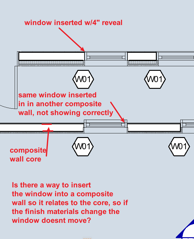

is there a way to attach a window and door to a wall composite core?  So if the composite wall finishes change the window doesn't move.  Attach window to composite wall core (2x framed wall) without having to change the reveal setting each time?
2 Replies 2

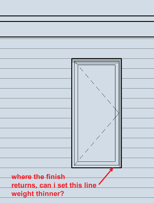

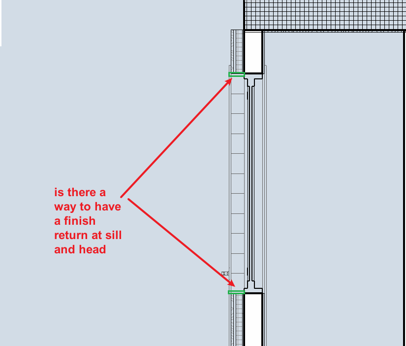

This is a continuation of windows being attached to composite walls and the seetings needs to accomplish as indicated in the attached snaphots.
DGSketcher
Legend
@dmdemara Yes. See help on reveal depth [HERE]
