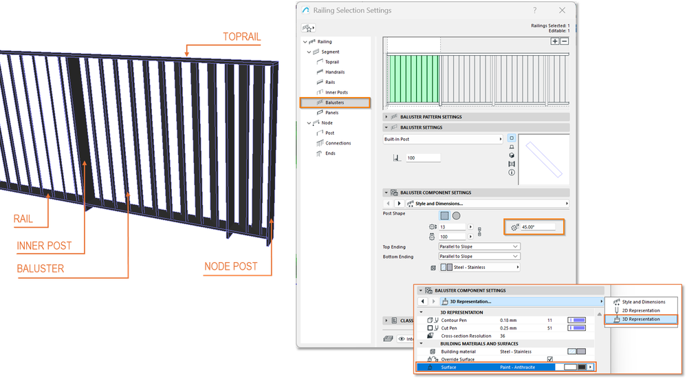

To change the surfaces you have to go into every element into Component settings -> 3D representation and surface.

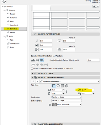

To rotate them:
Ricardo Lopez
Hi @Wayne Blythe
Balusters can be rotated using the settings in the Baluster component settings> Style and Dimensions.
You can select their building materials and override their surface as well (Baluster component settings > 3D representation).
Review all the baluster types for segment and nodes to ensure they meet your expectations.

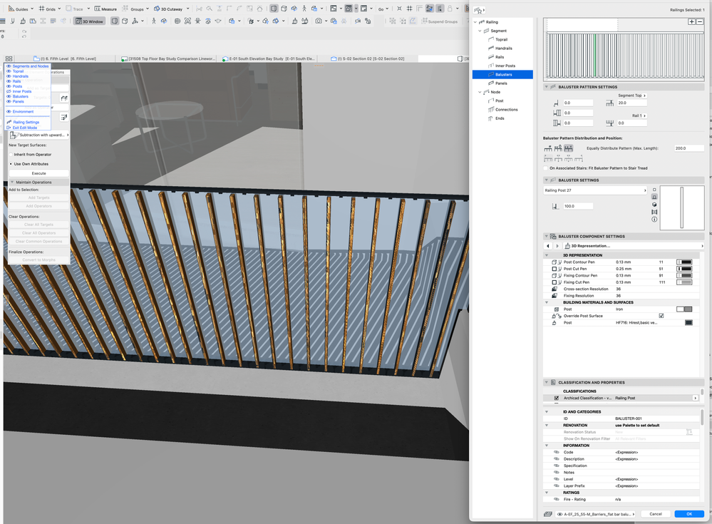

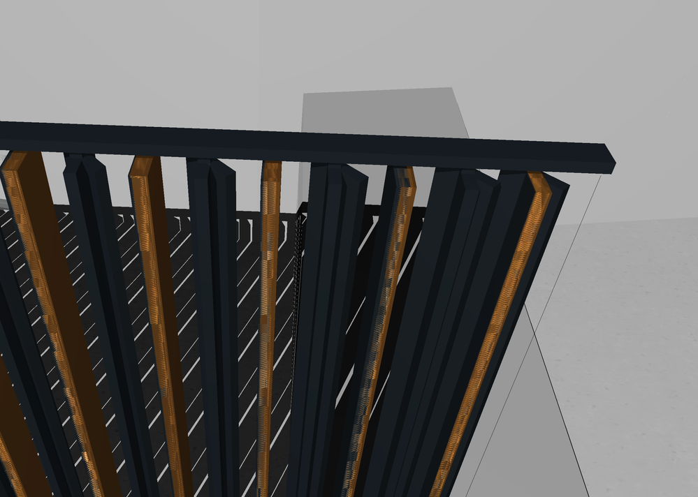

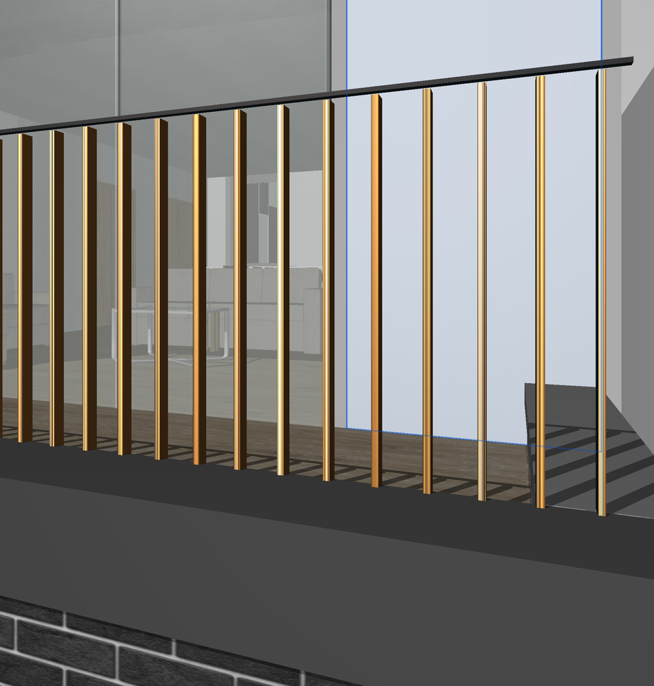

Wayne Blythe
Thank you i have changed all those settings - it seems there is multiple balusters and i cant delete them.

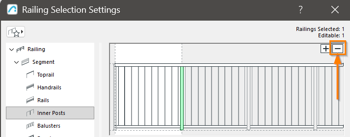

Ricardo Lopez
Hi @Wayne Blythe
Click on the baluster you want in the top diagram so that it turns green, and then click on the “-” symbol to delete it.
Watch the attached video file.
